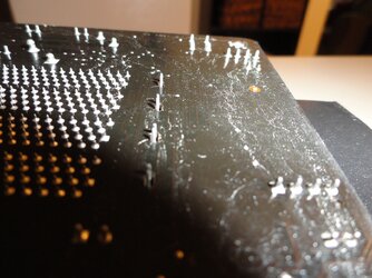

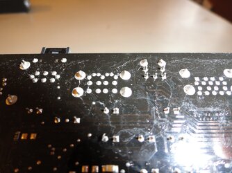

Just unboxed the mobo and about to pretest. Snapped some pictures first, because it appears to have some minor residue on the backside (It was open box):
Those were taken immediately after opening the box and looking at the board. Just in case I have to call Newegg for problems - nothing else apparently wrong at first glance, so about to power it on and see if it works before I defile it. On the upside, all accessories were included in the box, which I've heard is often not the case for Asus open box items.

Matt, the white stuff is just soldering flux, seen that on many refurb boards
