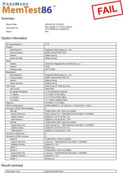

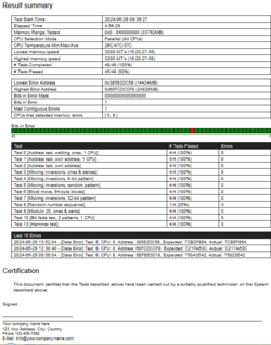

PFN_LIST_CORRUPT BSoD last week, games and browser tabs randomly crashing, now MemTest86 is reporting errors.
Vishera
Jul 7, 2013
Number of tests: 48, 45 passed
Lowest error address: 0x38582DC58 (14424MB)
Highest error address: 0x60FCDCCF8 (24828MB
1 bit in error, 1 maximum contiguous errors
CPUs that detected memory errors: {0, 8}
3 errors in test 8
Based on all of this information, how much of a priority should I make getting this in for RMA/buying a new kit? Money's kind of tight right now, so even the relatively low cost shipping through the post office would be hard to swing, and I use my computer both for work and school, so downtime is a major issue. I should get some more breathing room in late August/early September, but I'm just worried it won't last that long. Thoughts?

I mean, it's up to you, if it's causing issues while working and school I'd prioritize it. If it's only during recreation then lower.
You could also try testing a single stick at a time. If it's one causing the issue you can remove it from the system until you can rma or replace
TRUE, I didn't think about that. I'll run the test on one stick when I go to bed tonight, and then the other tomorrow morning, and hopefully I get good results...fingers crossed.
Confirmed only one sick is bad. I have another 16GB kit lying around that I know is good, so I'm gonna throw that in and just run the system at the default 2400MHz. Having a lot of RAM is important for video editing and whatnot, so better that than limping along on only 16GB.
