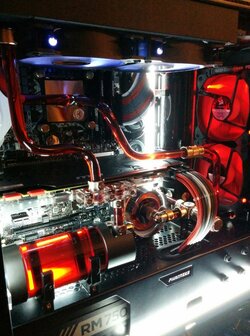

The bottom of this res was broken.. what a pain.. drained the loop, switched the bottoms of my 2 res and added a deeper going part into the broken res bottom, you can see it on the pictures, this solved my issue, no more leaks. Only problem is, I had to remake the biggest tube, the lenght wasn't good anymore..
But again filling:
This is a nice shot
I should take some more picture in the dark with the glass off, then you really see it all. Will add some later on!
