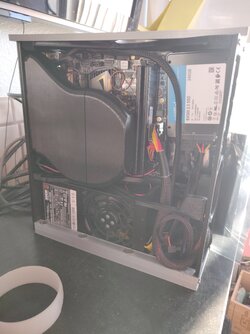

Initial assemby (using HSF from original build):
measurements for duct (and the low profile cooler I ended up going with):
The duct installed:

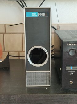

Case finished:

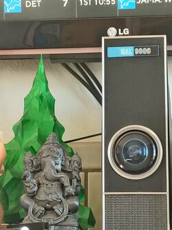

Faceplate attached (with 3d printed Nameplate... was going to get a decal made, but when you get a 0.2mm nozzle you gotta try):
This is a little out of temporal order, since I finished the faceplate first, then decided to make a case for it.
Current state:
TODO:
-The SDD is still just floating unattached in there. A bracket has been made (seen at the bottom of the last picture below Ganesha), just don't want to add a part I'll just have to take out when...
-Making the lens glow when the PC is turned on and slowly fade when its turned off. A circuit has been designed, but it requires cutting into the always on lines on the power supply and I don't want to go doing that willy-nilly
