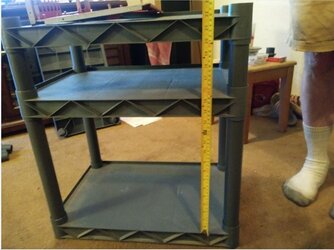

Anyone who read my ambitious thoughts in Johan45s Classified thread here http://www.overclockers.com/forums/...nd-LGA-2066(price-drop)-motherboards-for-sale is familiar with my visions of recirculating LN2, automotive water pumps and Honda Civic Radiators. Well, it turns out I also have to eat and live indoors, and if I don't budget for laundry my girlfriend won't come over anymore. Coming to these realizations I've scaled back my entry in to benching a wee bit. OK, a lot. Meet the $6 Goodwill plastic shelving unit:
Necessity may be the mother of invention but poverty is another kind of mother altogether, so elbow grease and creativity it is!

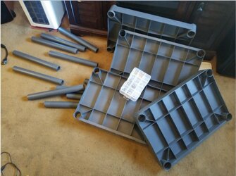

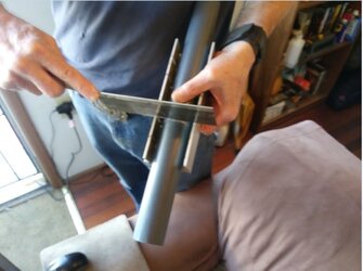

A small miter box and modeling saw...
...and I'm on my way to a functional construct!

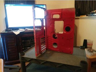

The lower deck will hold drives and PSU, and eventually a pump, radiator and reservoir, leaving the top deck for a motherboard tray and room for a multi meter and/or notebook. The motherboard tray and PCIe support come from an old case I took apart for this. Still a lot of trimming to do on it, and paint, but I think it has potential.
I cut an opening behind the socket, and intend to mount a fan on the underside of the top tray, blowing on the back of the socket. I also have the dreaded "Pentium duct" from a dead Dell I'm going to mount so it blows down on to the VRM heatsink from a vertically mounted fan off to the side. The ATX, VGA and CPU power leads will come up through cut outs, and eventually the liquid cooling lines to the CPU. Then paint, (still haven't chosen colors) and final assembly. Finally, with my very limited floor space, I can put it in a corner in my bedroom when not in use and it's the right height for me to sit on regular furniture when benching.

Do you plan to mount the motherboard tray vertical like that or lay it down horizontal?
It was just vertical for the picture. I'm thinking about a slight incline from horizontal just to keep a visual on everything while benching. It's being set up to be used while sitting on the couch at the moment, so it won't take much at that height. I still have longer corner supports if I get a proper stool and separate room for it in the future. I still have some serious trimming to do on the sheet metal, and it eats Dremel cut off wheels at a pretty fast rate. I'll be looking to mount/hang the PSU from the underside of the top shelf so I can route cables through the tray with some leeway for different boards/positioning. The underside of the shelves is braced pretty well, so if I can mount the ODD and HDD under it that will leave me lots of options for the future for mounting liquid cooling. :thup:

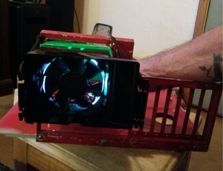

Pics! Not many, but what I have ATM. This isn't the final mounting system (Thank God), but I'm adding a VRM fan of epic (Well, Dell anyway) proportions.
I'll box in the end circled here
Good sized fan. It has an accessible resistor that runs it at 7v, but I can easily solder in a couple wires and a toggle switch to bypass the resistor for the full 12v. At that speed it sounds like a Tu-95 engine. LOL
I have to be careful about how far it extends, as I have a Hyper 212x coming. Once I get a water cooling system in place I'll have more room. And, obviously, this is just the mock up stage. I thought about just funneling the air from the Hyper 212 exhaust down to the VRMs, but figured why use hot air when I can put them in a wind tunnel? :clap:

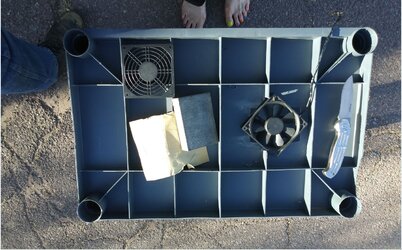

Cutting the table for the socket fan, with (one of) my handy switchblade(s) and sandpaper. And no, those are not my toes! Mine are to the left in the black boot. My nails don't look like that, unless it's a special occasion or something...:clap:

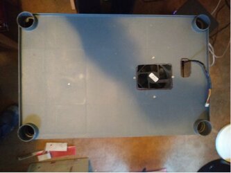

Done, fan installed with the cutout for the wires. The cover in the first pic is over the fan so I don't do something stupid when it's all together.

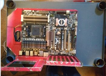

Cutout I made in the mobo tray for the socket. There wasn't one at all originally in the cheap tray. Also a cutout for the CPU and socket fan leads. It was originally just a punch out for a PSU lip.
Getting closer! Trimmed the tray corners to move it to the lip. I'll cut more slots for mobo cables when I get the PSU and figure out where/how I'm going to mount it. Should be next month on that. :thup:
Teh 'Kitteh! Still have a little metal work and paint to go, but I'm pleased with the way it's going. The buying of hard parts come in monthly bumps, but I decided to get a good air cooler for the time being while I acquire a solid LC set up. Power switch, audio jack, etc. still to come but I don't want to do anything else until I know exactly what I'm doing with the PSU.
