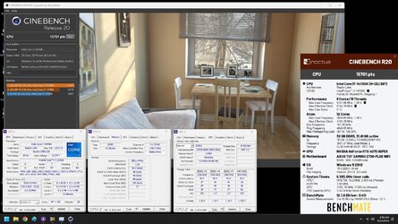

So purchased a TUF Z790 gaming and installed the first release 14th gen micro code. And so far the cpu seems to be running very well.
Keep in mind the 14700K I have has been used several times under DryIce. It still gives really nice results.
Having said this, I've been able to IMPROVE all of my benchmark scores since the replacement and using the release micro code.
Won't be doing any bios updates to this new board and will try and further improve some benchmarks scores in the future, perhaps I'll see some degradation in the future, maybe not. So far not.
CBR20 improved nicely. As per example below.
