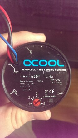

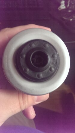

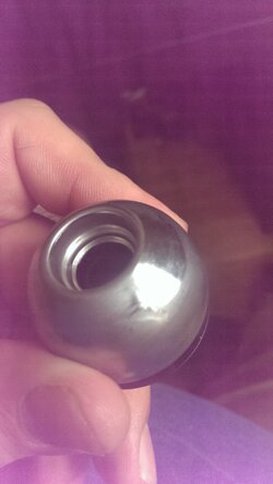

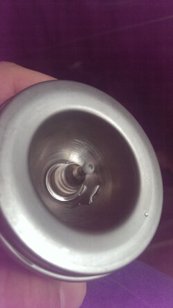

Edit: I have attached some photos of my pump, I hope it helps for now. As you can see, the speed can only be adjusted manually.
IMG_20160919_153027.jpg IMG_20160919_153045.jpg IMG_20160919_152947.jpg IMG_20160919_152929.jpg

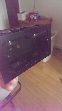

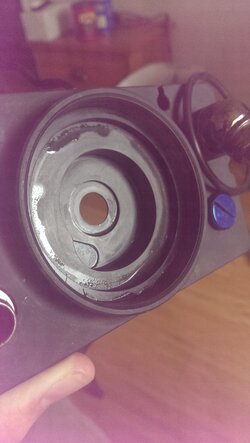

And also some pics of the res and how the pump mounts.

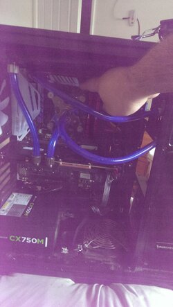

Edit 2
Will remount the rad later. The center post on the CPU block is the inlet. Then to the GPU, then to the rad, then to the res.

Soulcatcher668
Jan 2, 2012
I think the pump was damaged by debris in the system. Unfortunately I think the pump will have to be replaced.
That shiney part on that you see here..
is from rubbing on the housing. That cause unbalance and more rubbing.
I believe your only solution is another pump.
