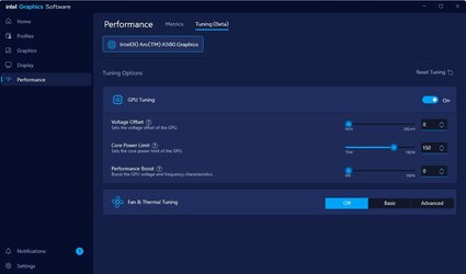

There are very small gains with both core and memory clocks on the GPU, but it's usually not worth overclocking over it. CPU is another matter, even if you don't overclock you will get better performance by running all the cores at the same speed instead of depending on the default core boost since it's a very intensive task, and it will start clocking down eventually if your cooling isn't top-notch. Yes, even if you encode on the GPU, and no, doesn't depend on brand. On that note, have been hearing very good things about ARC's AV1 encoding potential.
I tried adjusting what was called Core Power Limit and didn't see any real changes,I also adjusted the Voltage Offset and the Performance Boost and didn't see any changes either.
The stock setting for the Core Power Limit is 150 and that's the Maximum Watts the card can draw,the Voltage Offset and the Performance Boost were set to stock settings which are zero.
I raised the Voltage Offset to 15 and ran a test and then left that setting alone at 15 and then raised the Performance Boost from zero to 15 as well and both those settings were on 15 and this was all done with 175Watt setting on the Core Power Limit.
The temp's of the card never went above 42C
135 Watt Limit .910 to .978v Watt's the card used while testing 55 and 60 Watts 1000.23fps
150 Watt Limit .966 to .990v Watt's the card used while testing 55 and 64 Watts 1000.98fps
160 Watt Limit .950 to .980v Watt's the card used while testing 56 to 63 Watts 1004.83fps
175 Watt Limit .978 to .982v Watt's the card used while testing 56 to 61 Watts 993.97fps
1017.94fps
The test file I used was a tv show that was 960x540 being encoded to 720x404 and the times were between 1:07 to 1:10 minutes,I also used MP4 for the format and the video encoder was Intel H.264 QSV as the encoder setting as it is like a hybrid AV1,I find that the Intel H.264 QSV can compress stuff a bit more without hurting the video quality and will play just fine on any device unlike AV1.
If you look at the last fps of 1017.94 I ran the last test again after getting 993.97fps and then got higher numbers.
With the last test that result didn't surprise me at all I have seen this before if I run the same encode back to back and you'll get a different number,most times number will be 4 to 7fps difference,also with Handbrake it doesn't matter where the compression setting is either from what I have found the time it takes to encode a video is pretty much the same with 1 to 2 seconds difference in time any in change at all.

I don't know if you can adjust the core/memory clocks on this card,I don't know if you can tell by the picture if you can,that a screen shot of the only spot on my Intel Control Panel where you can adjust things,I tried adjusting all 3 before when I did my first testing,the middle slider you can raise or lower the value but the top and bottom slider can only be increased.
