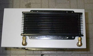

here's a pic I found on procooling.
Quite a nice job, but still would look better inside IMHO.

My only question is WHY? Why did he mount the rad ouside the case. That case that he has you could mount a chevy chevette core at the top above the p/s with the fans duct out the back and the intake at the top.
I read that article, it's an awesome case, however I definitely would have put the rad inside. I really don't see a point in putting a rad outside a full tower case. :burn: :)

With the rad out of the case, both the rad and the case get fresh air.
Actually I just read the article and it's exactly the reason given by Mr. B for "thinking outside the box" :)
