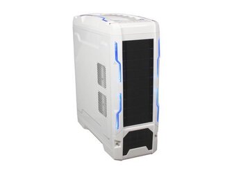

Azza-Link
Genesis 9000-DISCONTINUED
  • Motherboard Support-Mini-ITX, Micro ATX, ATX, E-ATX & XL-ATX
  • Fan/Radiator Support
    • Front-None
    • Rear-120mm(fan inluded)
    • Top-up to 480mm or 2x 230mm fans(included)
    • Bottom-240mm or 2x 140mm(fans included)
    • Right side-2x 120mm(fans only-included) & 200mm(L&R side panels are interchangable)
    • Left Side-2x 120mm (fans only)
  • Pump Mount-No
  • I/O Panel
    • 2x USB 2.0
    • 2x USB 3.0
    • 1x eSata
    • Headphone/Mic
    • Fan/LED Speed Toggle
    • Power button
    • Reset Button
  • Drive Bays
    • External – 9x 5.25″
    • Internal - 5x 2.5”/3.5” (2x include hot swap)
  • Clearances
    • Heat Sink-200mm
    • Graphics–400mm
    • PSU 2x 240mm
  • Rear cable management-Yes
  • Newegg Link

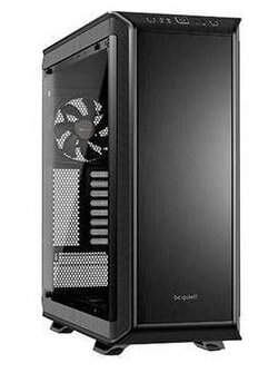

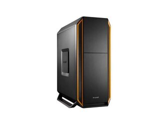

Be Quiet!-Link
Dark Base Pro 900
  • Motherboard Support-E-ATX, XL-ATX, ATX, M-ATX, & MINI-ITX
    • Front-up to 360mm or 420mm(2x 140mm 1,000 rpm SilentWings® PWM fans included)
    • Rear-120mm or 140mm (140mm 1,000 rpm SilentWings® PWM fan included)
    • Top- up to 180m, 360mm, or 420mm (Mounting point of 180mm radiator is c/c 154mm)
    • Bottom-120mm, 140mm or 280mm
  • Pump Mount-Yes
  • I/O Panel
    • 2x USB 3.0
    • 2x USB 2.0
    • Headphone/Mic
    • Power button
    • Reset button
    • Integrated charging pad for Qi enabled devices
    • Fan speed switch(inside door)
  • Drive Bays
    • External – 2x 5.25″(Inside door)
    • Internal - 7x 3.5” (removable and can house 14x 2.5”) & 1x 2.5" (behind Motherboard tray)
  • Clearances
    • Heat Sink-185mm
    • Graphics–325mm or 470mm(w/o drive cages)
    • PSU-150mm or 180mm (w/o bottom fan)
  • Rear cable management-Yes(28mm)
  • Newegg Link

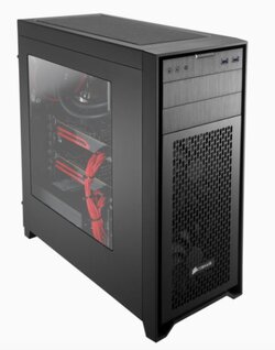

Obsidian 750D
  • Motherboard Support-Mini-ITX, Micro-ATX, ATX, EATX & XL-ATX
    • Front-240mm/280mm(2x 140mm fans included)
    • Rear-120mm/140mm (140mm fan included)
    • Top-up to 360mm or 280mm
    • Bottom-120mm w/cage or 240mm w/o cage
  • Pump Mount-No
  • I/O Panel
    • 2x USB 2.0
    • 2x USB 3.0
    • Headphone/Mic
    • Power Button
    • Reset Button
  • Drive Bays
    • External – 3x 5.25″
    • Internal - 6x 2.5”/3.5” & 4x 2.5"
  • Clearances
    • Heat Sink-170mm (review claims 180mm)
    • Graphics–340mm w/ cages or 460mm w/o cages
    • PSU-200mm(Corsair website claims 220mm)
  • Rear cable management-Yes (30mm)
  • Newegg Link

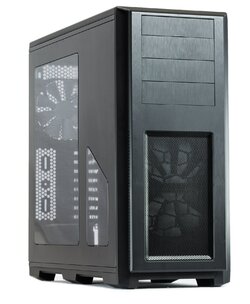

Phantom 630
  • Motherboard Support-XL-ATX, ATX, MICRO-ATX & Mini-ITX
    • Front-200mm (200mm@800 rpm fan included)
    • Rear-120mm/140mm (140mm@1100 rpm fan included)
    • Top-up to 360mm, 280mm(up to 60mm thick) or 2x200mm(fans only)(200mm@800 rpm fan included)
    • Bottom-up to 240mm/280mm
    • Side-200mm(fan only)(200mm@800 rpm fan included)
    • Pivot-120mm/140mm(fan only)
  • Pump Mount-No
  • I/O Panel
    • 2x USB 3.0
    • 2x USB 2.0
    • Headphone/Mic
    • Rear LED Switch
    • Fan Speed Switch (3 speeds)
    • Power Button
    • Reset Button
  • Drive Bays
    • External – 4x 5.25″
    • Internal - 6x3.5” 2x 2.5”(behind MB)
  • Clearances
    • CPU Heat Sink-200mm
    • Graphics–325mm with drive cage, 507mm without
  • Rear cable management-Yes(30mm)
  • Newegg Link

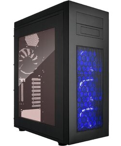

Rosewill-Link
Rise & Rise Glow(Front LED fans)
  • Motherboard Support-SSI-EEB, SSI-CEB, Extended ATX, ATX & Micro-ATX
    • Front-upto 360mm(verify rad size-some will not fit)(80mm total thickness max)(3x 120mm fans included)
    • Rear-120mm/140mm & 80mm(140mm Fan included)
    • Top-up to 240mm/280mm(15mm&20mm spacing supported)(100mm total thickness max)
    • Bottom-120mm(Verify PSU clearance)
    • Side-None
  • Pump Mount-No
  • I/O Panel (Top)
    • 2x USB 3.0
    • 4x USB 2.0
    • Headphone/Mic
    • Power Button
    • Reset Button
  • Drive Bays
    • External – 1x 5.25″ & 1x 5.25" or 3.5"
    • Internal - 2x 3.5”/2.5"(removable) & 2x 2.5”(behind MoBo tray)
  • Clearances
    • Heat Sink-180mm
    • Graphics–Unrestricted
  • Rear cable management-Yes(20mm min)
  • Newegg Link

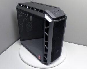

Cooler Master-Link
H500P Mesh
  • Motherboard Support-Mini-ITX, Micro-ATX, ATX, & E-ATX(12" x 10.7")
    • Front-up to 2x 200mm(fans only), 360mm or 240mm (2x200mm 800RPM RGB fans included)
    • Rear-120/140mm (140mm 1200RPM Fan included)
    • Top-up to 2x200(fans only), 360mm, or 280mm (70mm total Rad clearance)
    • Bottom-None
    • Left Side-None
  • Pump Mount-No
  • I/O Panel
    • 2x USB 3.0
    • 2x USB 2.0
    • Headphone/Mic
    • Power button
    • Reset/RGB Button
  • Drive Bays
    • External–None
    • Internal-2x 2.5"/3.5” & 2x 2.5”(6x 2.5" possible per review)
  • Clearances
    • Heat Sink-190mm
    • Graphics–412mm
    • PSU-ATX PS2
  • Rear cable management-Yes(25mm)
  • Newegg Link

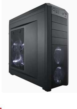

Corsair-Link
Carbide 88R (Review not available yet)
  • Motherboard Support-Mini-ITX, MicroATX
    • Front-up to 240mm
    • Rear-120mm(120mm fan included)
    • Top- 2x 120mm(240mm rad is possible but has restrictions. Description)
    • Bottom-none
    • Side-none
  • Pump Mount-No
  • I/O Panel
    • 1x USB 3.0
    • 1x USB 2.0
    • Headphone/Mic
    • Power button
    • Reset Button
  • Drive Bays
    • Internal - 2x 2.5” (behind MB Tray) & 2x 3.5”(Removable/Reversible Cage)
  • Clearances
    • Heat Sink-150mm
    • Graphics–383mm
  • Rear cable management-Yes(apx 13mm)
  • Newegg Link

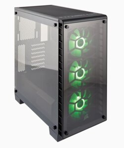

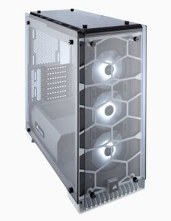

Crystal 460X & 460X RGB
  • Motherboard Support-Mini-ITX, MicroATX, & ATX
    • Front-up to 360mm or 280mm(3x 120mm SP120 RGB fans included)
    • Rear-120mm
    • Top-up to 240mm or 2x 140mm(fans only)
    • Bottom-None
    • Side-None
  • Pump Mount-No
  • I/O Panel
    • 2x USB 3.0
    • Headphone/Mic
    • Power button
    • Reset Button
    • 3 Button RGB Controller
  • Drive Bays
    • External – None
    • Internal - 3x 2.5” & 2x 3.5”
  • Clearances
    • Heat Sink-165mm
    • Graphics–370mm
    • PSU-200mm
  • Rear cable management-Yes(Minimal)
  • Newegg Link

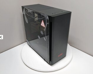

XPG-link
Invader
    • Front-up to 360mm or 240mm (1x 120 mm 1200 RPM fan included)
    • Rear-120mm (1x 120 mm 1200 RPM fan included)
    • Top-up to 240mm
    • Bottom-120mm (fan only)
    • Side-up to 240mm
  • Pump Mount-No
  • I/O Panel
    • 2x USB 3.0
    • Audio In & Out (supports HD Audio)
    • Power Button
    • RGB button
  • Drive Bays
    • External – None
    • Internal - 2x 2.5” & 2x 3.5"/2.5”
  • Clearances
    • CPU Cooler-170mm
    • Graphics–400mm
    • PSU-225mm
  • Rear cable management-Yes (18mm-adequate)
  • Amazon Link / Newegg Link

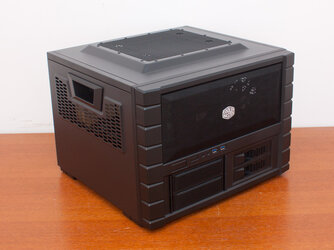

Cooler Master-Link
HAF-XB
  • Motherboard Support-ATX, Micro-ATX & Mini-ITX
    • Front-240mm (2x 120mm fans included-1800 RPM)
    • Rear/Top-120mm
    • Rear/Bottom-2x 80mm
    • Top- 200mm
  • Pump Mount-No
  • I/O Panel
    • 2x USB 3.0
    • Headphone/Mic
    • Power button
    • Reset Button
  • Drive Bays
    • External – 2x 5.25″ & 2x 3.5/2.5" (hot swap)
    • Internal - 4x 3.5/2.5”
  • Clearances
    • Heat Sink-180mm
    • Graphics–334mm
  • Rear cable management-Yes(Under in this case)
  • Newegg Link

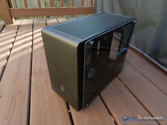

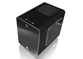

Raijintek-Link
Metis Plus
    • Top-120mm Fan
    • Front-None
    • Rear-120mm Fan (120mm LED fan included)
    • Bottom-None
    • Side-None
  • Pump Mount-No
  • I/O Panel
    • 2x USB 3.0
    • Power button
    • HD Audio In & Out
  • Drive Bays
    • External-None
    • Internal- 4×2.5" + 1×3.5" or 2×2.5" + 2×3.5"
  • Clearances
    • CPU-160mm
    • Graphics–170mm or up to 240mm
    • PSU-STD ATX PS/2
  • Newegg Link
