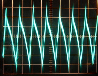

This is a good example of long waveform ripple:
Note that you can see the medium and short duration ripple imposed on the long duration.

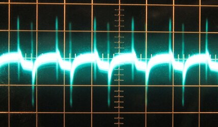

This picture is a wonderful example of both medium and short duration ripple:
Short duration ripple doesn't have to originate in the rail it comes out in, either. As the MOSFETs charge and discharge the inductors (APFC) and transformers (5VSB, 12V, 5V, 3V3) there is an external magnetic field that changes violantly, that's the only reason this stuff works in the first place. However, changing magnetic fields induce current in conductive materials they are around. Welcome to EMI! The field of the main transformer switching for 1500w is quite intense, while the electrical output goes through proper filtering to smooth it out the field can induce transients in the modular PCB or in the output wires. The PSU case acts as a faraday cage to keep this EMI hell internal, and good PSUs are set up so that the wires and PCB traces are the wrong length to receive the EMI signal strongly (just like an antenna, the wrong length means terrible reception).
