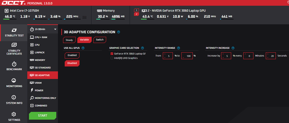

Here is a run on OCCT with a zipped .csv log of the data, along with screenshots of the test setup and the V/Freq. curve as seen from MSI Afterburner.

Just images of the 2nd/Sensor tab of GPUz is all we need. I'm not sifting through another spreadsheet unless I have to, lol. I'd imagine if you look at Performance Limit - Power there will be a YES there because it's banging off the power limit.
All you need to see there is the reason it's capping the power (Perfcap reason). But like I said, OCCT is a stress test, and I'm not at all surprised to see it throttle clocks back during stress testing. That's normal because of the extreme loads it puts on the GPU.
As far as this happening in games, the max boost is dependent on temperatures and power limits (among other things). So at some point the card will settle with clocks and voltage that fit under the limit. You're in a laptop so thermals can be more of an issue than with a full desktop card. Even without power limits, once you get into the 60's, it will start to drop boost bins too.
So far though, I don't see an issue with anything. :)

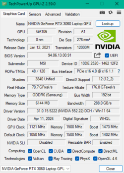

If you look at the first page on GPUz, it will show you what the base clock is and the boost clock is. Will you post that picture up, please? I forgot to ask earlier. But my point is that, in games (not stress tests) you should be around or above that boost clock value in GPUz. :)
Super-grateful for your patience and help. See attached.
So, the base clock is cut off in the image, but, in taking a quick glance at your spreadsheet, the clocks appear to eventually be right at or just below, the boost clock that's listed there, correct? Seems like it's trying to hold a higher clock, but trickles down to ~1,402 MHz - your rated boost clock. But again, the stress test is just beating it into submission, lol.
If you capture game data, I'd guess it should behave the same or run even higher clocks as it's not a stress test beating it down. ;)
Sorry about that, trying to do about 5 things at once today. Below is full shot showing the base clock as 1050MHz (I've started curve editing while chatting). Cheers, and I think I'm good from here, as I feel like I understand and don't want to monopolize your time. Last question is if I should shoot for no errors when stress testing OCCT.
