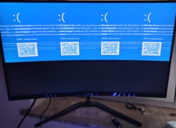

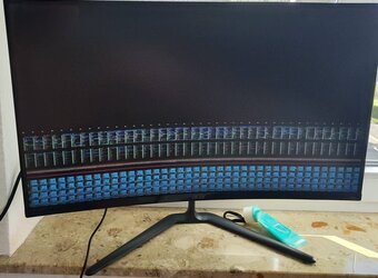

Would appreciate if you could advise something regarding my problem with iGPU driver issues on Windows 11. I mean it seems to me it's iGPU related but I'm not sure. Several days after building PC and Windows installation it started to act strange - freezing, black screens etc.
I tried to reinstall Windows and use Drivers from official Website for Mobo and CPU. But during Adrenalin 24.7.1 driver installation and after my monitor blinks, turns black, I see different artifacts, sometimes PC freezes completely including BSOD.
One thing that can help - I have 2 totally similar Computers using iGPU. On the 1st I have these issues, on the 2nd one - everything is fine. The 2nd PC (working properly) - the iGPU driver is Version 31.0.24028.3. Seems like It was installed by Windows Update but I'm not sure.
Unfortunately I did not have time yet to try Adrenalin 24.7.1 on the 2nd (working) PC to test whether it works well with these drivers.

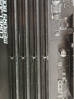

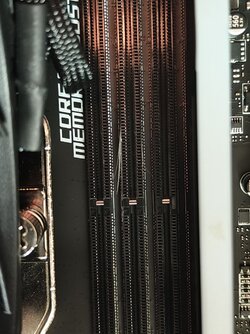

Then we passed to the Problem PC and checked RAM - found strange glass fibre piece looking like tiny hair in one of the RAM slots close to the outer wall of the slot. Removed it and now trying to boot but still face with black screen / freezing.

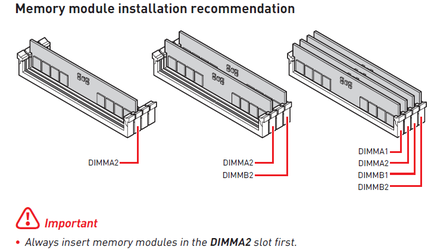

Trying to boot with 1 RAM stick but not in the recommended 2nd slot (where we found that inclusion) but the 4th one. Don't know whether it can be done by that since the MSI recommends to use 2nd slot for 1 stick of RAM.
Still can't understand what inclusion was that - whether it's from the factory or it's me somehow...
Do you find it as a serious damage?
Can I use 1 Ram stick in any slot I want there or it can damage PC?
Screenshots before / after inclusion removal enclosed.
Thanks a lot!
I don't think having RAM in the "wrong" slot will do any damage. It's more of a question about it working but not damage.

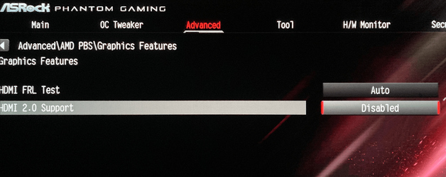

I'm using a 7600X and an ASROCK B650 PG Lightning and I probably found the same symptoms.
I was able to go beyond the logon screen when I disabled HDMI2.0support from UEFI.
In this state, the screen becomes abnormal during or immediately after installing ADRENALINE. There are two types of error dialogs at that time: "Incompatible/Driver timeout".
After this state, when I restart, the logon screen goes black 100% of the time.
The screen still freezes as if there is insufficient memory, but the screen output returns any number of times if I wait 10 seconds.
I looked up the manual for MSI's MSI PRO B650-S WIFI motherboard, but there was no similar option with the same name.
Indirectly changing the memory speed or iGPU voltage did not improve it much, and I also tried replacing the HDMI cable, but it did not improve even with a cable that normally outputs 4K120Hz with the 3080ti.
