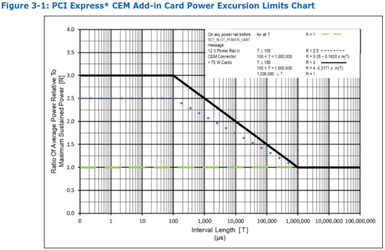

I'm actually curious how it works, but maybe forced shutdown by OCP/OVP after longer load above the specs. Lower wattage units have lower efficiency at 100-115V, but I'm not really sure how that 2kW FSP works. ATX3.1 PSUs have allowed spikes up to +100% of the maximum wattage. Now I also wonder how 4kW spikes would look in a typical home environment ... I have 230V here in Poland, but only ~3.2kW total in my apartment.
Without looking at the spec, I'm guessing the output is rated for that power, which would be delivered by capacitors in the PSU. Some kind of inrush limit so you don't at the same time try to pull excessive from the wall. I'm also assuming it is for a very short time only so it shouldn't have a long term impact.
Edit:
Max peaks allowed up to 100us, dropping to no excursion at 1s or longer.
