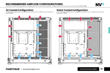

The case is attractive due to its small size (relative to radiator capacity) at 575 x 280 x 615 mm. Here is the suggested water cooled configuration:
The SR2s are somewhat chunky but I understand there will be just about enough clearance between the rear and top rads. I am thinking to go with these rads because of the 140mm form factor giving large surface area for effective cooling and the low 9 FPI fin count, which should facilitate lower fans speeds. The NF-A14s are just what I have in my current build so I was thinking to get x4 more to match the ones I have and throw in another fan hub (water temp controlled or set to constant 400 or 500 rpm). The QD3s look amazing for easy loop maintenance - can't wait for these. I already have an Alphacool NexXxos ST30 140mm and HPE30 420mm in my loop until I get the Hardware Labs replacements (the following payday).
