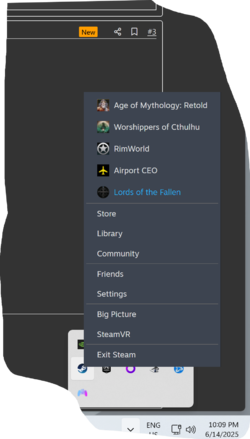

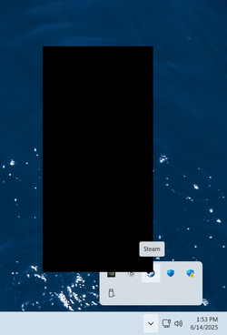

I ran into an issue with (rather, because of..) my new monitor. I used to run 2x 1440p monitors (75Hz/165Hz). I upgraded the 165Hz monitor to a 4K/240Hz ditty. After doing so, the right click menu from the Steam icon in the taskbar pops up black*. Annoying as that is normally how I launch my Steam titles (it keeps 4/5 of your latest in that menu). Getting frustrated it wasn't a 'driver thing' I decided to hit the g00gl3s.
Apparently, this is a known and longstanding issue when the monitor's resolutions differ. *Specifically, it happens after my monitor powers down (OLED, so I set it to shut off after 2 minutes). When I come back, that menu stops working. Steam seems to be aware of this, but hasn't fixed it/worked with whoever needs to fix it.

3. Move the window between the monitors and 99% of the time it fixes my issue.
