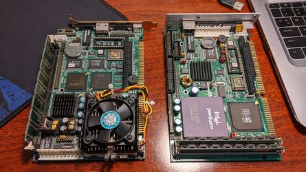

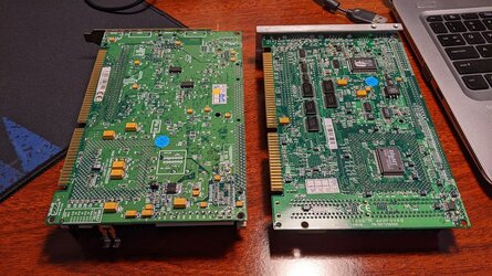

I've been wanting to build a retro system for a while but I didnt want another big honkin tower right now so I got some hardware that goes in a bit of a different direction. SBCs
I got these for super cheap, the one on the left needs a tantalum cap on the back of the socket replaced, you can see it was ripped off some where although the seller said it worked regardless.
But i need a case for these, something small. i thought some one some time ago made external housings for PC cards and small PSUs but I'm either not looking up the right thing or they dont exist. I remember having a sun microsystems external scsi drive that was sort of like what i imagined, it had a PSU in it but the case wasnt off the shelf suited for PC cards.
At this point i'm kinda looking for any thing that can fit these, i could do external PSUs if need be. It wouldnt matter if it was a single slot or two or three, there is some expansion on these cards.
some insight on these and what i'll use them for.
well mainly i'll use them for DOS, Win95/98 stuff. probably not any D3D things but maybe depending on what i find when i probe these a little more. probably use DOM or a CF to IDE adapter and a floppy emulator. these have most everything else onboard so unless i need to add anything the'll probably be run as is
the one on the left is a socket 370, i think it has a celeron installed but i have a few pentium 3's stashed away, 133Mhz 128MB DIMM . every things onboard, 10/100, USB,video, Sound, HDD, FDD, it almost all headers, even some funky tiny IDE looking LCD connector. I think its kinda interesting that its a socket 370 with an AT PSU connector, i think it was designed mainly as an upgrade board.
the right one is a Pentium 133, I think its a socket 5, but i'm hoping its not. again, everything onboard, this one came with 16 megs SIMM installed, not sure the speed, i see a j-60 so maybe 60ns? I wish it was EDO, i have a bunch of that still, i dont have many of these older SIMMs.
