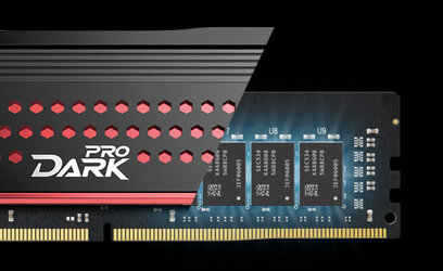

Packaging is often an overlooked element to a finished product, but it shouldn't be. The packaging is just a delivery mechanism to ship the product safely, but it also serves as the first impression of quality. We have all opened products with cheaply made packaging and whether you acknowledge it or not I believe that it has an effect on the first impression of the product.
The Dark Pro packaging does not disappoint. While it is incredible simple and effective, it does lend a feeling of quality.
The heatsink design and look is incredibly subjective, but one thing is certain, when you hold the memory in your hands you get the feeling of quality. It has weight and the overall fit and finish feel excellent. On a personal level I strongly dislike anything RGB. I think the memory should be neutral and blend in to the system without standing out. I think the the Dark Pro modules fulfill that requirement perfectly with the predominant color being black and the highlight colors being either gray or red. They blend into the system and allow you to focus lighting efforts in other places.
Dark Pro in Red
With just a small flash of red, they blend in nicely with almost any system. Here you can see then paired up with the ASRock X299 OC Formula.

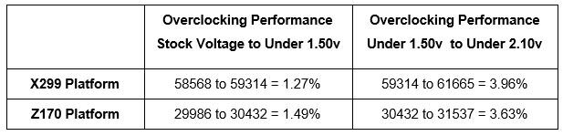

For each platform I will examine the overclock potential under various conditions as described above. However, I thought it would also be interesting to look at how Geekbench responds to increase in memory speeds. Looking at score improvement with only memory overclock is not just a curiosity, it's a real world representation heavy load daily functions.
High End Desktop: X299 Platform, Quad Channel
Test 1: XMP 2.0 (Stock Voltage)
Score: 58568
Test 2: 3733 14-14-14-31 (1.50v or Under)
Score: 59314
Test 3: 3800 12-11-11-24 (Under 2.1v, Actual = 1.85v)
Score 61665
Mainstream Desktop, Z170 Platform, Dual Channel
Score: 29986
Score: 30432
Test 3: 3733 12-11-11-24 ((Under 2.1v, Actual = 1.80v)
Score 31537
Below is the calculations showing percentage gain of overclocking memory

As I have shown above, the real world gain in performance from memory overclocks beyond XMP is really not practical. The maximum performance I was able to achieve was about 3.5% but this required voiding the warranty and severely limiting the life of the hardware.
