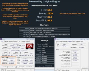

I typed into g00gle, free + game + benchmark. One of the first 'hits' to appear was a link to Heaven DX-11 Benchmark in Version 3.0. I am not a gamer so no idea what such a game might involve or look like or any of that, but I read what the link seemed to say.
I could download Heaven DX-11 Benchmark and running it would 'not' assure that I could run the game but would show me something about how the Unigine Engine would react to my system components. At the completion of the 26 'steps' of the bench it would give some sort of result. From "my" earlier testing in this long thread, I felt that 4.4Ghz, 4.6Ghz, 4.8Ghz and finally 5.0Ghz were the peak speeds that gave me a performance boost compared to a lesser cpu speed.
So sight unseen and no experience at all with the bench, I downloaded the Unigine Benchmark and began to run tests with it at the 4.4, 4.6, 4.8 and 5.0Ghz speeds. I benched with bench in it's base/default settings. NO adjustment was made to the bench at all. I mean we have a newbie to the bench, why dork with stuff I am not familiar with? Didn't.
I had two ATI video cards for use. A stock 5770 and a stock 6850 that like a numb-nutts, I bought being into; "fits my price point". I used both in the testing. Of course the more powerful video card gave more FPS. I think that would be a given. But did I gain way more performance with either video card, if I increased the Cpu speed? I have the answer in my own mind. The bench results are for others to make their own decision.

Testing 5770 Video Card. Four cpu speeds.
CLICK Spoiler for three more test results at greater cpu speeds.

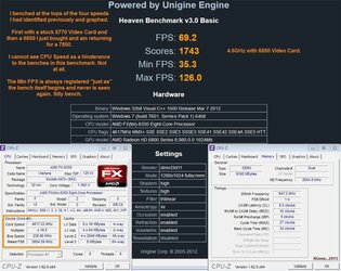

Testing 6850 Video Card. Four cpu speeds.

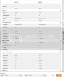

May I post a few of my benchmarks? Some are not stable overclocks on the CPU and some have utilized GPU tweak, but I feel they will illustrate similar characteristics to the info you've already provided.
I have benchmarks for Asus 7970 Direct CUii
Asus 680Gtx 4gb Direct CUii
and lastly Asus 7970 Direct CUii and Gigabyte 7970 in crossfire.
The most comparable to your results would come from the single Asus 7970 and benchmarks i've run with overclocks going up the ladder as I learned things from this forum!
Okay. If i'm reading the charts right, there is no significant increase in Frames when using a CPU overclock. So a monster clock isn't going to help your gaming video performance.
But, on the other hand I have these results from Benchmarks I did while learning more about the overclocking process.
*Disclaimer. I'm learning and these overclocks were produced with AMD Overdrive. What i've learned is that AMD Overdrive is not a suitable OC'ing method and to attain true stability more traditional methods and patience will provide better results.
So, on to my results from 3dmark11. Some graphics tests actually gained 10+ frames yet with 0.2ghz more CPU power the physics test only gained by a couple of frames (which when viewed on a large scale against higher clocked CPUs a few frames is actually a large margin on the benchmark.)

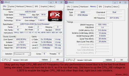

Test of a 6 core Piledriver...
...because of the goodness of one our forum members, I will be running some benches using an FX-6300 cpu.
Below is the first boot into windows. No sense in messing around. Punch in the numbers and go since I am not worried about cooling.
RGone...
I made a note of the two speeds that are not a match to the same ones I use with my FX-8350 so will REboot and fix that.
RGone...Again.
Okay did the REboot to change CPU_NB and HT Frequency to the higher numbers I always run. Keep it level. Well as close as is possible.
Air it is:

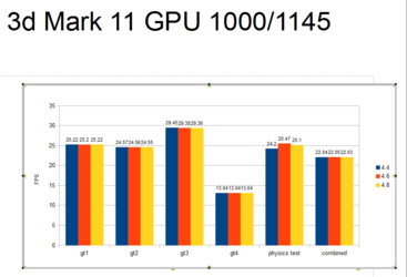

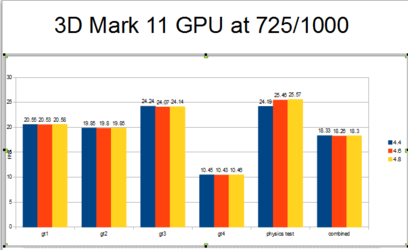

Ok so these tests had me thinking, so I did a few 3d Mark 11's myself. I was curious if I would have the same result as Fugu with the large jump in FPS on the graphics tests. I'm wondering if, because he has such a high end GPU that at 4.3ghz his GPU is being bottle-necked by the CPU. As you'll will see I did not have the same results. I hope my first foray into graphs will be easy to understand. What I did was set the gpu at the stated speeds in the title above it and then ran at 4.4,4.6 and 4.8 on the cpu.
Well while you were gone testing, Fugu did another set of benches and he in fact got a better score at his lower stable speed. Similar to what your graphs show. So his first post of benches had to be off in some manner. His later bench seems to mirror your results and in fact just about what we have discussed. More cpu speed may not be worth the effort and certainly not if the configuration is not up to "poooshing-it".

I made sure to run everything the same in both benchmarks aside from CPU speeds.
I believe Voltage stayed the same for both runs too.
Are we defeating the purpose of overclocking or pushing for a way to look for the best configuration for the best output?
