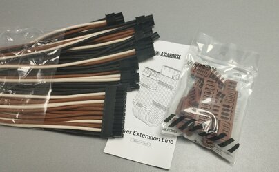

From cheaper brands, you can find AsiaHorse on Amazon. I'm not sure how it looks with all their products, but I'm using their extensions in one of the test rigs, which are pretty good quality. I also couldn't find other brand extensions that would be white with white connectors.
... and your question made me order brownish (classic Noctua look) AsiaHorse extensions for the new build

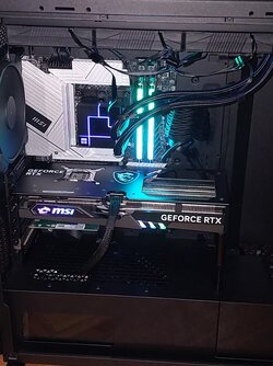

I will be using the one that comes with it, I am just unsure it will reach the GPU as I was looking it might be slightly short by few millimeters sadly and I might need to extend it as well and I would rather not have to waste 4 power slots to extend it.
As I understood https://linkup.one/linkup-ava-16pin...d-copper-teflon-high-temperature-jacket-30cm/ this would be the one that would extend the 600w that comes with my PSU. No black thou sadge...
if I dont use that then I would have to use 4 power slots to equate the 600w and use the linkup on the psu and the psu on the other end as the extendable one.

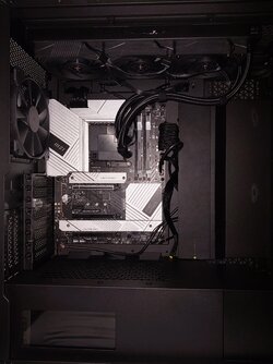

so the 24pin extension just arrived and I resumed mounting everything... this is what it looks like right now and I wonder if the pump tubes as they are is fine or if I should try placing it differently?

As far as the tubes.. I think you're OK, but taht picture is....sideways? Any chance to put it the right way?
my bad :)

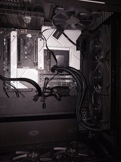

I am still fixing some cables like that sound cable down there is now coming from behind so its completely hidden.
Looks good! Clean!
If you want, that front panel audio can probably route below and pop out so that wire is hidden. :)
Looks good! Clean!
yeah that is what I did haha :p or rather what I meant by what I said above, its exiting from that hole there now 1722624169235.png so u only see a lil bit.

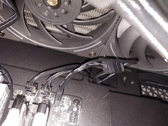

The repeater that have all the case fans plugged, I plugged to the sys_fan3 hope that is ok 1722624217883.png

The GPU cable was just able the distance without forcing the cable or doing any hard curves.
The extensions I mentioned some time ago just arrived. AsiaHorse brand isn't very popular, but they are available on every Amazon and are pretty good quality (I have white ones on another PC). I don't know if you think about a graphics card or the full set. The 12VHPWR cables are almost only black or white. I have the AsiaHorse working with my RTX4080 for some long months without issues.
