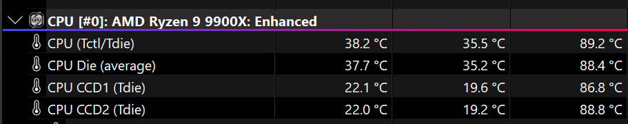

Looking at what is good and reasonably priced recently, I would get Arctic Freezer III. However, I can't see a significant difference between 280 and 420. I have both, and with AMD or Intel rigs, CPUs boost up to the same clocks and manually OC the same too. Even if there is a difference in temps, then it doesn't matter. 280mm rads are usually about the same as 360mm. Arctic coolers include offset mount as standard, so they generally give you a few degrees better results on Ryzen (more like 0-3°C on most CPUs). I also have a better experience with Arctic fans than Alphacool.
The idea of an offset mount drives me crazy for some reason.
That reason being you should not have to offset anything, just engineer better.
It's not required. The same way as you don't have to delid or overclock at all. The offset gives 0-3°C as I mentioned before, when the temp under load is 90°C+. It's better to have it, but it really doesn't matter much. For me more annoying is that these coolers don't fit all motherboards. They should leave an option to use a regular mount or offset. 3 out of 5 motherboards that I first used with my Freezer III, had too close PCIe slot or too large heatsinks.

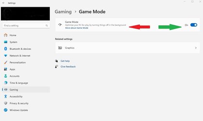

anyway i dont know that i'd trust it but this is interesting looking:
Ahh... not using it. (I don't see 'parking' anywhere).
This is interesting though! Start a new thread for discussion so as not to steal this one's thunder. :)
