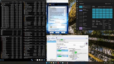

Sorry, its for another team... been awhile since I ran Rosetta.. cuts into F@H by about 2-2.5M PPD.. hm.
On the plus side the PSU is spitting out some warm air :D
