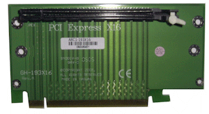

anyone know of a video card that mounts parallel to the mobo instead of perpendicular?
What you're looking for is a 90 degree PCI-E adapter. Any PCI-E card could possibly fit with that, but you'll have to watch the cooling. A 2-slot cooler on the card might make it tricky.

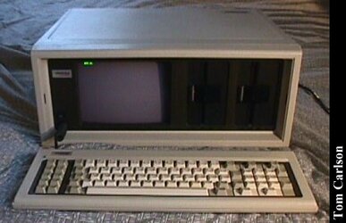

Funny how things come full circle. A whole bunch of years ago, I actually worked on one of these.. http://www.obsoletecomputermuseum.org/compaq/
keyboard locked in the bottom and covered the two drive bays and the leet greenscreen monitor.
Love the idea of making a full sized desktop more portable.
