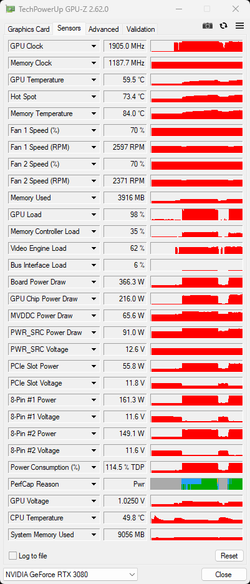

The first screenshot is stock GPU values but with the GPU fans manually set to 70% in MSI Afterburner.
The second screenshot is with the Power Limit set to +15% in MSI Afterburner.

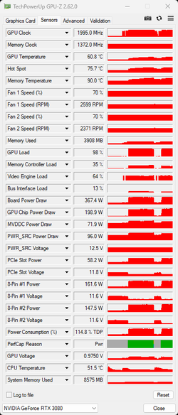

The third screenshot is as below, which is the maximum overclock I can now apply without crashing (which is not as good as I somehow got in 2023; hence this topic).
Third screenshot specs
I took the screenshots at roughly the same point - about 15 seconds into the second scene.
First screenshot Second screenshot Third screenshot
Please keep in mind the three CPU-Z screenshots show 'Current', rather than 'Highest Reading'.
So far, I don't see the ~1,500MHz core clocks you're talking about... it's running ~10MHz slower than what you listed in the first post.
Sorry, as mentioned above the two screenshots, they are without an overclock. One is fully stock (apart from increased fan speed), one is the same but with the Power Limit increased to the maximum (+15%).
I will run an overclock and post another screenshot.
Perfect. We know it's working right at stock...
I'm curious to see the Perfcap reason when overclocked...
Added the third screenshot :)
Please keep in mind the three screenshots show 'Current', rather than 'Highest Reading'.
Do you need the three screenshots taking again with 'Highest Reading' set, instead?
Still working right. I see a current clock speed of ~1995 MHz.
The key here is to show a screenshot of GPUz when it's throttling and around that 1500 MHz you mentioned in the first post. So far, it's not exhibiting the problem you've described.
Anything over +141 MHz Clock and over +1475 MHz Memory, I crash.
Screenshot 3 is using those numbers.

Perhaps I'm just tired...
....throw what values you had 'entered' in the past to reach those clocks away...
.....in the last GPUz screenshot, you hit the core clocks you initially reached, didn't you? And going past the memory???

Assuming that's true, I don't see an issue with the images you've posted. You could just be at the end of your overclock. It's that simple (so far).
I don't see anything that stands out either, your at your cards max of 115% TDP and temps are reasonable. you could unlock voltage control in msi and then crank that slider up and see if it still crashes over the +141 but like EarthDog mentioned if we can't see what it's doing when it gets knocked down to 1590 it's just a guessing game. You could change the graphs so it shows the highest recorded temps and you could run port royal in stress test mode to really push the card and see if you can make it downclock and then screenshot the gpuz results.

From what you showed us, you are reaching ~1990 MHz (see your 3rd gpuz image).
Have you run 3dmark again?
Also, where are you getting that you're running at ~1500 MHz??????? If it's from 3dmark, thats often wrong....
....rerun 3dmark (let it finish) now (with gpuz) and see what happens...
Until you can show us the clocks dropping, I'm afraid things are running 'normal'. I'll repeat...
Edit: after clicking into your 3dmark scores, I see you changed your system/cpu as well so you're not comparing like things either.
Edit2: I'd bet money t he ~1500 mhz you see 3dm reporting are the base clocks for your card (post a screenshot of GPUz... the first page with all the specs) but that doesn't mean your actually running the test at that speed... again, run 3dm the whole way through with gpuz and check those clockspeeds/post the image here. If you were running at 1500 mhz, your score would be a lot lower.
Your TOTAL score is actually HIGHER on the second 3dm run (because of the cpu/system change). There isn't a problem here at all outside of your gpu score being slightly lower... but that could be driver/overhead. Fromnwhat you shared, you are, clearly, hitting the same clockspeeds.
