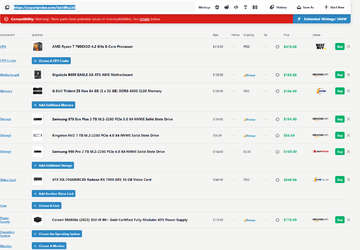

I've done some reading. Seems for CPUs AMD > Intel at the moment. AM5 > AM4, because AM4 is aging out. If Radeon GPU, then 7900 GRE seems like a decent mix of tradeoffs. But honestly, I could be partially or completely wrong. I've come up with a prelim build. Would appreciate critique and/or if I need to provide more info for good feedback.
Here's a prelim new setup:
No CPU cooler because I have an existing watercooling system I'll transfer to the new rig. I'll have to get a new CPU waterblock; researching that now. I miss Swiftech.
Bykski is fine for water blocks on AM4/5 because AMD just is not pushing as much power through the chips. They are not as good as EK or Swiftech but then, they are available.

A couple revisions I would consider. Getting a used 4070Ti over the 7900GRE. According to User Benchmark the 4070Ti is 23% faster than the 7900GRE. 23% is quite a lot for the same or less money. Changing the power supply out for one that has the PCIe 5.0 12VHPWR 600W plug built in so you don't have to use an adapter. I realize that AMD does not use this plug, but getting a PSU with one could future proof yourself for a future cleaner build. There would be no cost change on the PSU. Check out the be quiet! Pure Power 12 M 850.

I'm in if he's flush with cash, or it doesn't prevent him from getting other hardware. Otherwise, a properly installed adapter is fine. :)
Also, Userbench, as a long-time hardware reviewer, I stay away from that site. It's just not accurate in many cases.

The pricing is based off his build list. The GPU would be the same or cheaper and the PSU is $4 cheaper.
Good call in User Benchmark. The cards seem to be neck and neck. Depends on what you are doing/playing.

I like Techpowerup's GPU reviews... arguably the best on the net. Here it shows the 4070Ti around 5-6% faster at 1080p/1440p.....
As long as you don't enable RT then its +/- the same. When you do, even the RTX4070 non-Super is faster at 1080/1440p ... and uses 100W less.
The RX7900GRE looks good in reviews in terms of price/performance. I even commented on this in my review. However, it's hot, uses up to 320W with spikes up to 370W, and because of that (and cost cuts), most models are loud. I was testing Gigabyte with a large, 3-fan cooler, and sitting next to it at auto fan speed with 3x 3k+ RPM fans (almost all the time at max speed in 3D) was a pain.
Seems like the 4070Ti might be the better card. Less wattage, less noise. Better RT performance to boot!
I don't see a monitor in this build. If he's on an old 1080p screen the monitor would be just as important upgrade as the rest of the build.

Thanks for the referral to the Bykski water block line. I hadn't heard of them. What reading I had done was leading me toward an Alphacool CPU block, but it looks like some of these Bykski blocks are 1/2 the price. I don't need RBG, just a sufficiently good CPU block.
Alphacool still makes good stuff.
I will say, these days mid to high end air is as good as mid level water cooling. something like a peerless assassin heatsink will match an older 240mm rad with higher reliability and less maintenance.
