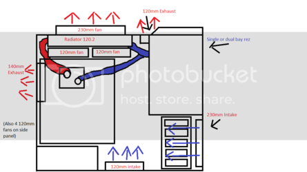

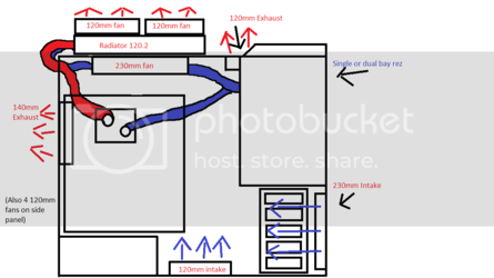

Ok so I'm hoping to water cool in the very near future. Not looking for anything to expensive or complex and I'm just wanting to cool my Q9650 and an i7/i9 in the future :). I am wanting to use a 120.2 RAD and a drive bay REZ as I really like the look of them. The pump will be built into the REZ, this makes it a more simple setup as this will be my first W/C rig. I know the pump won't be as good as a serperate good one but I'm hoping it will do just to get my toes wet :). I've been looking at these two:

Now as for the planning behind the setup. I've been thinking about 2 options. I'm not to good in paint but I hope you get the idea:
Option 1:
Option 2:
Not to sure which one to go with or what difference it will make (if any) but I think I would prefer the look of the case if the radiator was outside as in option 1. What do you guys think? :shrug:
Ditch the top 230mm fan. They are totally useless for watercooling. They may move some CFM, but the static pressure totally sucks as the flow is over a large area. Stick a 3 x 120 rad up top with 3 or 6 fans and call it a day. A 2 x 120 would barely cool an I7, yet alone an I7 with a GPU. The HAF easily fits a 3x 120 with absolutely zero modification other than removing the 230mm fan.
Most people would recommend pulling cooler air into the rad, but the HAF has good enough airflow, it doesn't matter that much to push case air through it. As you can see, you can easily fit a good triple up top like a PA 120.3 with at least 3 fans with room to spare. Six fans with a thicker rad may be tight but doable with 25mm fans. Don't think you could fit six 38mm fans.
I'm thinking a 120.3 RAD would be a little over kill for my use. I see your point about the 230mm fan, suppose I could use two 120mm fans to better affect.
Better to overrad than underrad. If you want to upgrade later to an I7 or even to just add a GPU in with the current CPU, a 2 x 120 will not cut it. The differnce in price between a double or triple is minimal. With my setup, my I7 still hits the mid to high 60's at load at 4.2. What do you think temps would be with just a double? Fail.....
