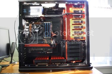

Thanks in advance and I'll be posting some pictures soon. Just waiting for a new case top. My original one was damaged in shipping and TT shipped it the morning I reported it. Very good customer service! As for their WC kit... Hmmmm what around the house needs to be water cooled? :shrug: Maybe the dogs water bowl? :p
For your viewing pleasure...
