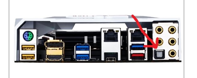

There is optical/spdif out on your motherboard...
I'm not currently home to look at it, but do you happen to have a picture with where that would be?

Sits with the Audio (the 1/8" jacks) section. You can see pics from newegg/giga website, etc.
That's my G7 board, I'm looking at my htpc build with the ASRock H110M board.
Going off memory, there is no digital output on that board.
Sorry missed that... it does not.
:( That's what I was thinking.
