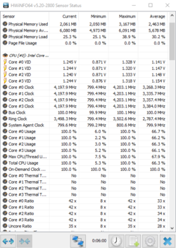

And in HWinfo64 I got this ...
Which one is real? I am worried that 1.6 is the one thats real even though BIOS shows vcore at 1.25

FYI: The VIDs you have in the screenshot of HWinfo64 aren't the actual voltage supplied to the CPU. The actual voltage is a single number listed lower with all of the rest of the system voltages. That's the one you should pay attention to.
HWinfo64 is what I use, as it has proven to be the most accurate of the monitoring programs for me.

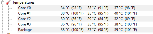

Thank you Mad, that 1.6 V got me worried. I did what u just advised and lowered the cpu Vcore to 1.2 in BIOS and did a quick 10 min stresstest with AIDA64. These are the temps I got, are they normal for 4.2 GHz @ 1.2 V ?

Btw your right Mad, HWInfo64 showed me correct I think
Is that the number I missed in my first post that I am supposed to watch out for? Because if so, it shows 1.2 which is exactly what I put in BIOS.
That's the correct number to be looking at in HWinfo64 for CPU voltage, yes.
And those are good temps, though I'd get rid of HWMonitor completely and use HWinfo64 for all of it. It has all of the temps, voltages, speeds, and usage numbers for the CPU, mainboard, RAM, GPU, and drives.
