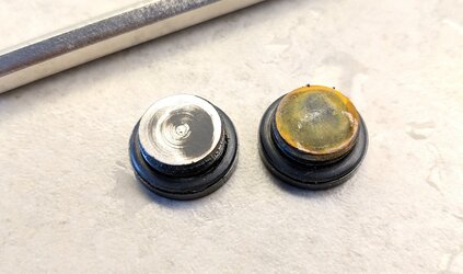

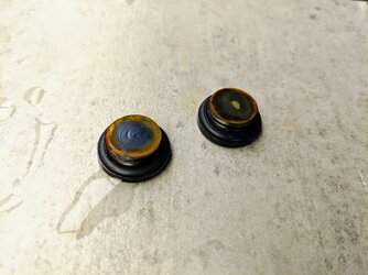

Now, when I tore that down to see if it could be an issue with the tubes (read about plasticizer being a potential culprit) I noticed that two plugs in unused ports of the res really looked corroded:
I took some ultra-fine sandpaper to try and clear it away and was surprised to find a shiny white surface underneath, where all my other plugs where brass. I was initially worried this was aluminium causing galvanic corrosion.
On an off chance I tried these on a magnet, and they really stuck to it. So this must be iron or steel, and not the stainless kind. Or if it is, some really poor grade of it.
Is this normal, or are these parts faulty? Never heard of painted steel plugs. Not 100% sure, but think these came with my evga hydro copper.
