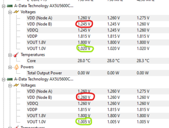

I recently purchased a DDR5 kit from ADATA - XPG Lancer AX5U5600C3616G-DCLABK. It's a 5600 kit with CL36 rated at 1.25V with Hynix A chips. It works perfectly and stable, without errors after a 2-hour test in Memtest86. However, I noticed that there are small variations of 15 millivolts between modules. This makes me wonder if there might be an issue with this memory kit.

Another issue is that the memory sticks are labeled with a voltage of 1.250 V, but they actually run at 1.260 V, which I didn't encounter with the other two kits that ran at the specified voltage on the modules
Furthermore, the other modules only have VDD node A. For these Adata XPG modules, a value for VDD node B has appeared, which did not exist previously
I dont see a problem here (or any of the voltage differences mentioned). Small differences, especially this small, (read from software) I'd consider normal (regardless if other kits didn't show a difference).

I agree with Earthdog but there can be problems with different voltages, but if you don't encounter any issues in your OS, then your golden.
It's normal to see +/- 0.01-0.02V. On my ASUS Apex, when I set ~1.45V, hwinfo64 reads ~1.42-1.45V. When I set ~1.60V, the readings are around ~1.55-1.58V.
It can be a matter of motherboard or used PMIC on memory modules.
As long as it's stable, then I wouldn't search for problems.
