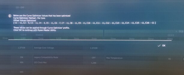

I was able to complete a Ryzen Master:
default Curve Optimizer Per Core run at -25 with these results
Co1 -11 co2 -9 co3 -11 co4 -3 co5 -11 co6 -7 co7 -11 co8 -11 co9 -11 co10 -11 co11 -11 co12 -11 co13 -11 co14 -11 co15 -11 co16 -11

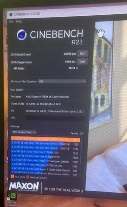

so what would be the next step? Apply the values in bios? Cinebench scores at default were just about = to previous EXPOII scores tested both EXPOI & EXPOII profiles EXPOI scored highest at 36960 muilti and 1954 single MP Ratio 18.54 x ACBDBE57-9AB9-4EC5-92D8-ED98EAAA4CC6.jpeg
Well save those values then! Make sure auto OC is at +200 and re-enable EXPO I. If it's stable then you're done I think.

What score were you expecting and where did you see it?
The advice to use the BIOS is because most users here don't do the auto thing, mainly for the reasons you were having issues with, causes instability, all kinds of stuff. I believe most of the advice given was to set the actual manual curve and that's where a bit of miscommunication happened. But if it worked out, and you can re-enable everything.
Well I was expecting 38 to 39 but only got to 37, but after 30 min Cinebench run to check stability it finished but then crashed so I set it back from EXPOI to auto. Seems stable but I’m running the Core-cycler bat file from the guide I linked that uses Ycruncher to stress test each core in order, if one crashes you go in and adjust that core down 5 then retest

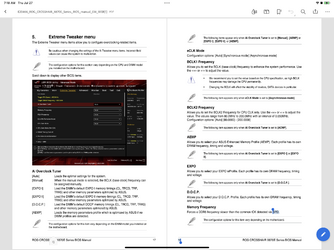

Okay so I can see how this was super confusing and I'm sorry (since what you're doing is applying some sort of automatic overclock program over and over, and I kept referring to Auto OC). In my defense I did mention that I was working off of older references. Apparently your board uses the following settings (under the Advanced tab, AMD Overclocking menu)
74ROG CROSSHAIR X670E Series BIOS Manual
CPU Boost Clock Override
Increases (Positive) or Decreases (Negative) the maximum CPU frequency that may
be automatically achieved by the CPU Boost Algorithm.
Configuration options: [Disabled] [Enabled (Positive)] [Enabled (Negative)]
The following item appears only when CPU Boost Clock Override is set to [Enabled
(Positive)].
Max CPU Boost Clock Override(+)
Increases the maximum CPU frequency that may be automatically achieved by the
Precision Boost 2 algorithm. Use the <+> or <-> to adjust the value. The values range
from 25 to 200 with an interval of 25.
Configuration options: [Auto] [0] - [200]
The above setting will allow the CPU to boost 200MHz higher when possible given the other parameters of power draw and temperature. You might not necessarily see it, you're just raising the cap. When everyone says to go +200, this is what they mean.

When you say default settings, for me on the Extreme Tweaker bios options there is only Auto, manual, EXPOI, and EXPOII options. Do you set it to manual? and not change any settings?
I have tried -30-20-10-5 Curve Optimizer settings on Auto, EXPOI, and EXPOII profiles with no luck all crashed as soon as I logged in, but my motherboard is acting different now so I might try it again.
Below is my bios info from the manual my chipset doesn’t show D.O.C.P. or AEMP options
