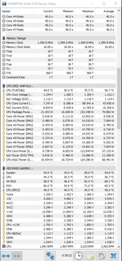

Now I'm back home as you can see from my Sig. Feels good! Cinebench scores are 66% higher on my R7 2700 overclocked to 4.0 ghz than they were with my 7700k overclocked to 4.8 ghz. Since I'm not a gamer the small decrease in per core performance was not an issue for me. FlareX 3200 runs at full speed no problem on A-XMP.

Johann45, the MSI B450i gaming plus AC we were discussing in another thread does now have the ability to increase vcore as high you need to for overclocking but there is a problem with granularity. You can only change the vcore in .0125 increments. That's kind of weird. I settled for 4.0 ghz because that is the highest stable overclock on 1.35 vcore I could achieve. You hear different things but most are reporting that AMD says 1.35 is the limit they recommend to prevent chip degradation. The other two complaints I have about the board are:
