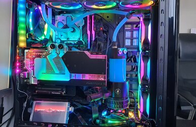

I am running a single pump, dual 360 radiator + 120 radiator, CPU + GPU water cooled system. 20200816_144100.jpg It has been running fine for 3 years and during that time I have purged, cleaned and replaced the coolant 3-4 times.

Here's a picture of the system, in case it helps:
