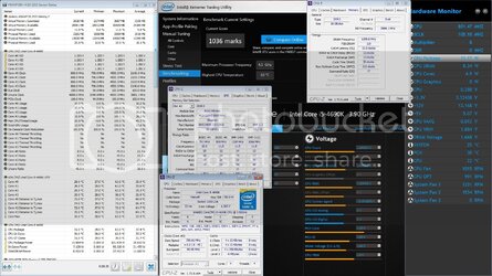

My best Intel extreme tuning utility score with the improved xmp settings iETU_1036 10_12_13_30_313_1t.jpg

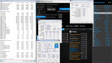

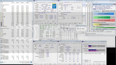

A 1600 999 24 1t comparison vs 2400 10 12 13 30 313 1t 1600DDR9-9-9-24-208-1t.jpg

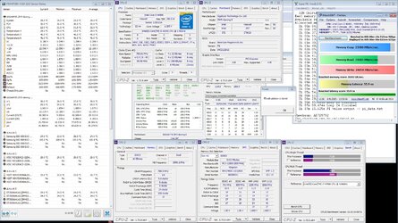

2 x 8Gb Hyper X Savage 2400 @ 10-12-13-30-313-1t 2400DDR10-12-13-30-313-1t.jpg
