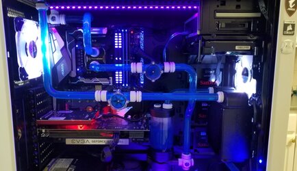

Pictures of first water-cooled build
Guys,
Here are the pictures of my first hard line water-cooled build. A special thanks goes out to GTXJackBauer :clap:and Maxfly :clap:for their help and advice in getting this build off the ground. Thanks guys!!!!
Gordon
Nice Job! it looks good! just gotta slip that gpu into the loop now ;) what gear did you end up going with?
Thanks Guys,
I posted some additional pictures under a new post that shows some more details as I didn't know how to change the post from New (first) Water cooled build questions/suggestions to pictures of my completed build. I hear you about adding the GPU to the loop, but its a low end GPU so not much point plus I couldn't find a water jacket for it. I plan to upgrade the GPU after my wife has gotten over the sticker shock of this build. The gear I ended up going with is as follows:
