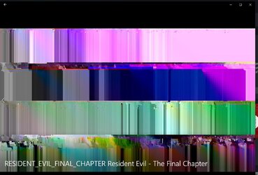

I have been ripping a lot of my movies to my plex server as of late. When I'm ripping them, I'm using MakeMKV, and DVD's everything comes out fine. However, the problem occurs when I try and rip my Blu-rays, when i go to play back parts of them start looking scrambled like trying to watch a naughty channel on the cable box as a kid. On the flip side I tried another program I had (VideSolo) and ripped Lossless and it did the same thing. But if I rip it using compression (Hq1080p) the playback is just fine no scramble. So, I figured I would try a different computer all together and got the same issue. (Only thing in common is the video cards). I tried swapping the Blu-ray player same thing. Reloading windows, updating MakeMKV etc. No luck. I'm beginning to think my hardware isn't capable of keeping up anymore.
Current Computer (need to upgrade eventually)
intel 4790k (no oc)
16gb ddr 3 1600
asus z97-ar mobo
EVGA 1080 GTX
Alternate computer
intel 7700
32 GB ddr 4 2400
EVGA 1080 GTX
MSI pro B660M-A
Possibly running out of decoder? That being the case I would probably need to upgrade my hardware (i figured this is invadable the way windows is going)? If so any suggestions? would this be more video card related than cpu? I kind of figured if i was going to upgrade I'm Gunna go AMD this time around, just not sure which processor or video card i would go with.
