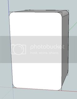

I decided to do a little basic SketchUp to get a feel for the overall shape:
The primary shape was based on this simple profile:
A simple upright rectangle with rounded corners (3cm radius bends).
The general shape was going look like this:

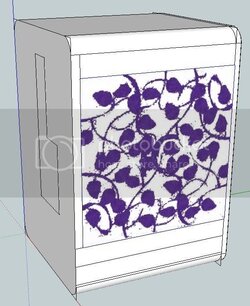

To incorporate the vine and leaf motif, the large front and back face panels would have the vine and leaf motif, like this ghetto SketchUp attempt:
The panel would be white, the vine and leaf pattern would actually be a cut-out from this surface panel, revealing an underneath purple plastic layer
Forgive my awful photoshopping skills, but it would look a little more like:
