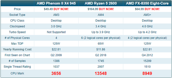

WoW is my main game of choice as well and I have experience with how it behaves on a wide range of systems. It leans more heavily on CPU than GPU, especially in Org or SW. I have a computer in my office right now that runs it at 60pfs+ depending on location on just a AMD FX-8350 stock with 16gb ddr3 1866mhz. That being said, if solid performance in WoW is your main concern, you don't have to break the bank. Here is a comparison of your current CPU, the 8350 i described, and a Ryzen 5 2600 (non X). snatch a 2600, b350 mobo and a 2x8gb kit of ddr4 ram and you'll be golden.
