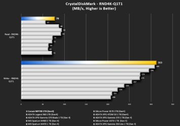

Anything is possible with new drives, but we actually found an issue in our testing.
Cliff's - CDM was updated for this review, and we figured out one of the benchmark's tests changed after digging deeper into the anomaly. It appears the MP700 ran a different test than all the other drives in the 4K random. The other results appear to be within variance, but we're double-checking everything.
We'll add an editor's note and an updated chart ASAP. :)

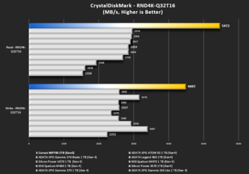

Yes the third test default used to be RND4k Q32 T16 for CDM v7.0.X and the new default vor v8.0.4 is RND4k Q32T1. So the test was run on single thread. I'll be re-running the benchmarks and updated this review shortly.
I re-ran the Crystal Disk Mark benchmark with the original default settings and these are the results. We will be switching the format slightly for the next NVMe review and I will run this drive with those settings too so that we are back to a level playing field. (as level as technology will allow that is)
