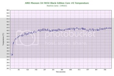

To give an example of this, here's two graphs of a heatsink im using that relies 100% on heat pipes to transfer heat to a fin array.
This graph is my system, a Phenom 9850 running at 2875Mhz at stock 1.3v. As you can see my idle temps are quite low, and my load temps are quite good also.

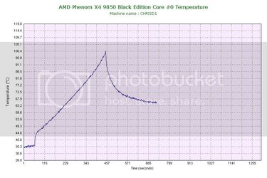

Now here's what happens to those load temps when i increase only the voltage to 1.3375v.
In the second graph, there are multiple places where the temperature begins to plateau, and almost stabilize before jumping up to a new level. At around 52c, it breaks through and starts to rise dramatically. Had i not stopped Prime95 from running, those temperatures would have continued until my system crashed or my chip fried. To give you an example of an extreme situation i encountered...

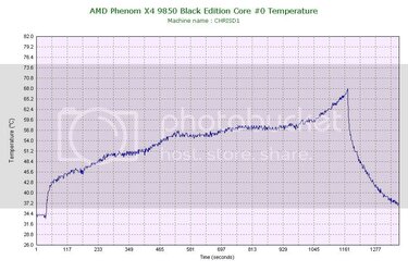

This was the first time i had installed this heatsink. The overclock i had at the time was around 3.1ghz with 1.45v. My stock AMD heatsink was having stable load temps in the low 60c range. That heatsink is a more traditional design, fins attached to a block, that also has heatpipes running from the base into the fins to help. But it does not rely on heat pipes.
