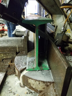

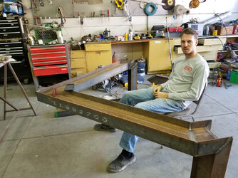

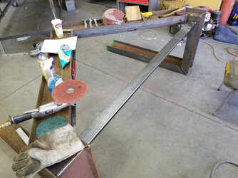

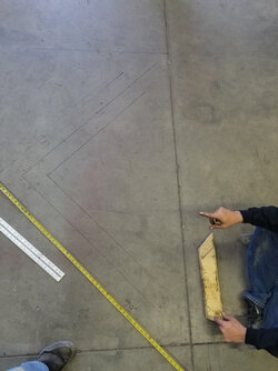

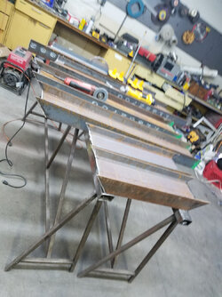

My idea would be to build the frame of the desk out of metal and use an exotic African wood (I have done work in Africa a couple times so this was a sentimental thing for me) as the top. Since this was going to be a unique build I didn't want to have it look like a normal desk either. I wanted a V shape but with the V floating and only having 2 legs. The wood would be set inside the V and the computer and cooling system would be built into the legs and feet of the desk. I started sketching it out and figuring out all the measurements/angles that would be needed to make this work and be the size that I wanted. You will see below what I came up with.

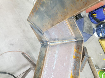

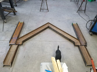

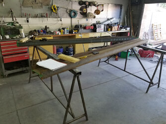

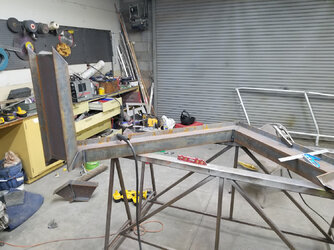

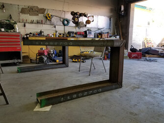

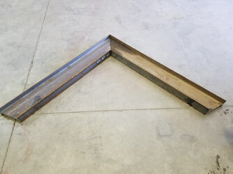

So far here is what has been completed:

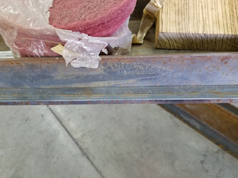

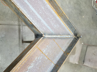

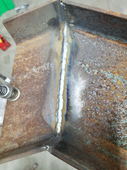

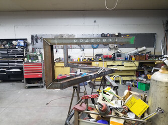

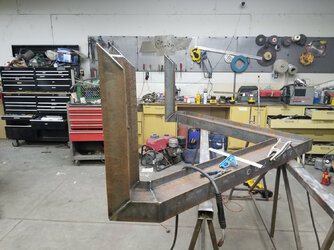

-Frame has been cut and welded together by me (I just learned how to weld. This is my first big project so the welds are not all perfect but I don't care. I still did it myself. HA)

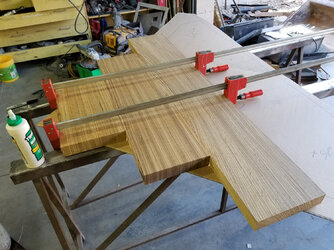

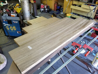

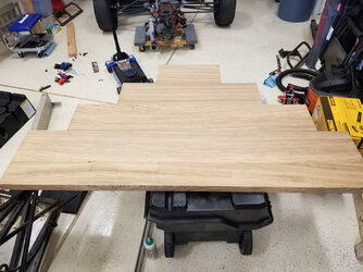

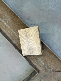

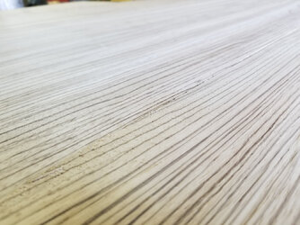

-Wood has been bought and mostly glued together. I went with an African Zebra wood. It is extremely dense and heavy but looks awesome. Wasn't cheap either though. Just the top was almost $900 worth of wood.

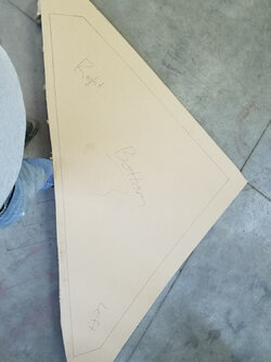

-Rough cuts have been made on the wood to fit inside the V of the frame. I need to glue the two smaller wood sections together still then cut the entire thing to fit.
I hope to continue working on the desk part and have that pretty much completed this coming week before I leave for almost 2 weeks again for work. Once I get that done I will be able to start laying out the components. I am thinking about using more of the Zebra Wood as the mounts for the motherboard and the radiators but am still undecided at the moment.
