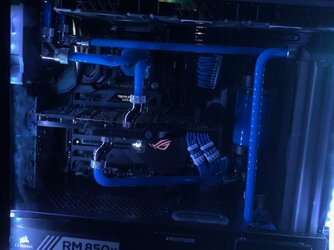

Here is a crappy picture to show what I've done. I still need to clean-up a few things. Cable combs, fingerprints on the glass, the backplate of the gpu.. etc..
You're certainly a better writer than photographer! LMAO
OK seriously now, I'm not nearly as verbose so I'll just say great story and I'm glad it all worked out in the end.
I wish for so many people to read thus and heed the advice. So many want to jump right in and just do it, which can lead to problems, and more time and money needed. :)
Cheers guys. It really was meant to be a word of caution tale. So much time, money, and a few drops of blood wasted -- but on the plus side so much learned along the way.
EarthDog -- love the Wilbon quote. PTI is one of the best.
READ EVERYTHING YOU CAN MORE THAN ONCE, MEASURE TWICE CUT ONCE, CUT LONG AND CUT AGAIN, MAP OUT YOUR BUILD WITH EVERY SINGLE FITTING YOU NEED and most of all.. TAKE YOUR TIME -- IT WILL SAVE YOU IN THE LONG RUN!
Way better advice than having to exclaim "I keep cutting it, but it's still too short!"
