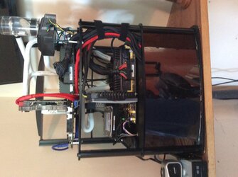

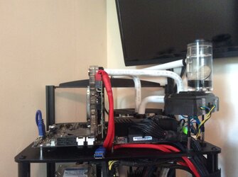

I ended up getting 2 cheap open bench stands and modifying them slightly so they would stack one on top of the other. Took a little trial and error of course to make sure everything would fit.

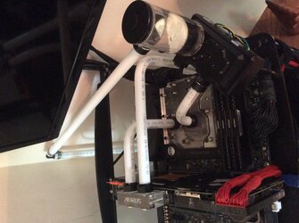

The plan was to get some more clear hard tube to repipe the two systems into one. So I ordered the tube and then decided to use some PEX to get an idea of the runs and bends I would need. I had no idea that PEX could be heated and shaped like acrylic. I was also unaware of just how tightly both PEX and acrylic could bend while maintaining its shape. I’m running it with the PEX for now until I decide what changes need to be made. I had no clue it would work so well and was so easy to shape. Much easier than acrylic. And the writing washes off with a little alcohol.

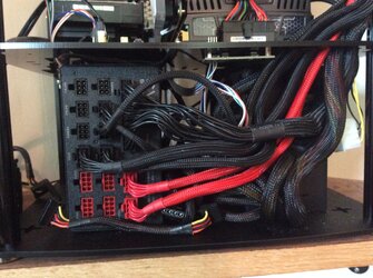

The PSs are mounted on the bottom. I cut a piece if plexi so that it would sit in the grooves of the aluminum supports and applied some limo tint to it. This hides the PSs and cables nicely.

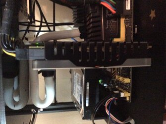

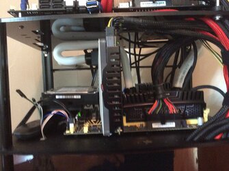

The next level houses my wife’s computer. It’s the i7-4790 and Zotac 1080ti Arcticstorm. The Apogee Drive II pump/block on it is hooked to my PS and MB so my machine has to be running for her machine to be on. I ran the system with just this pump running and it worked fine so I may hook it to her machine just in case my machine shuts off for any reason.
The top level is my machine. A Ryzen 1700 And Gigabyte 1080ti Waterforce. The MCP35X2 dual pump is driven by my machine.

After running for a couple of weeks now I’ve determined that I will have to put the SB and memory coolers on just my machine as they are little heat factories. Running some temp,tests now but so far neither CPU is going over 54c and the GPUs stay under 46c. Water hasn’t hit 30c yet after 4 hours of heavy multi-core gaming at 4K on both machines at the same time. Probably won’t do a real test until the SB and memory are under water.
