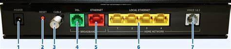

I just completed a new build & clean install using the referenced mobo. After everything was up & running I noticed the Ethernet Port was dead. The Device Manager indicated the Intel Ethernet Controller I225-V was properly installed with good drivers but it still appeared dead when an Ethernet cable (proven good on my laptop) was plugged into it. Neither light on the RJ-45 connector would light and the W10 troubleshooter stated no cable was plugged in. Asus tech support had me load three different drivers and then told me the board was bad. I received and installed the replacement mobo today and to my great dismay, the damn thing still would not work. After a few hours of trying various things, including a different power supply, new cables, etc. I got the idea somehow to use a powered switch between the wall jack and the computer. The other end of the wall jack is an AT&T Uverse RG. To my great relief, the light on the RJ-45 lit up and it works perfectly. I plugged the computer directly into the wall jack and, again, no joy.
