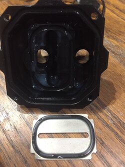

After disassembling my entire system, here are some pictures. I did find some rusting (??maybe this is just the bare copper underneath??) in the radiator threads and on the Bitspower barbs (inside the barb and on the threads as well) and I'm not sure if this is the issue causing the murky water. I basically took these pictures of the radiator, waterblock and barbs/fittings right after I disassembled the system (without cleaning) to examine the parts:
Copper doesn't rust. It will tarnish, corrode and turn green. Bitspower fittings are brass with nickle plating. I'm leaning towards that Mayhems fluid causing all the trouble. I had Mayhems colored fluid in my system and in less than 6 months just broke down, turned into a jell substance and clogged everything. It looked like watered down vomit (ugh). I had to take everything apart and wash/scrub it all to hell to get it cleaned. I did the boiling hot water into the radiator dance for hours. What a pain in the @&& that was. I went back to distilled water and biocide (PTH-Nuke). I went with blue tubing from Primochill. Never again will I use any colored fluid/dye I don't care how "good" it is.

it will depend on the corrosion. if you can see the brass on the threads/inside the fitting you should replace them or the nickel/chrome plating(not sure which it is) will continue to come off and cause issues. i try to do a complete teardown of my loop evey year or so now. so that i can check my blocks and fittings for plating issues. in my experience most fittings will fail no matter how well we clean our loops. the better the loop is cleaned and flushed the slower the degradation is. my assumption is that because of the turbulence caused by most fittings it just wears the paint/plating away over time. the same will happen to blocks but its usually a much slower process. i think cpu blocks are more inclined to get eroded or gummed up(turn black) because of the huge amount of turbulence they create by default. gpu blocks are less so because of the way they are built(full coverage not gpu only). my current loop has been free of any kind of break down thankfully. i attribute that to having taken much better care of it. ive replaced the fluid in it 3 times in the last 18 months because of leaky 90 degree fittings. im certain that those failing helped the rest of my loop stay cleaner by forcing a flush and fill lol. im going to do my best to flush and fill every 6 months regardless. ive invested alot of money in blocks and fittings and would like them to last as long as possible!
being that those fittings have plating issues i would pull all of the ones like those. replace them if there is even a pin prick of corrosion on them or black discoloration. check any others(45s,90s) very closely for paint or plating problems as well.
