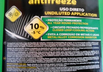

BTW this is the antifreeze i have @home any good ?
if it is the anti-freeze you guys talk about.
"it haves anti-corrosion agaist all type of metals and alloys , including aluminium." its what says in the descripiton label.
Pulsa: From your PM to me, just ask here instead.
I have no idea about the anti-freeze you have. Back in the old days late 1990's and early 2000's folks talked about Volkswagen antifreeze and I think Toyota as good stuff. One was blue, one was red. They said it was the best ones to use. Otherwise I don't have a clue, never used that stuff.
No luck on the pump top? Didn't think you would have any luck. Best bet is to return the pump, save and buy a better pump and use distilled water. You don't have to watercool right away right?
What about a DDC 3.2/3.25? A Swiftech pump MCP 35x/50x? A D5 basic? A D5 Vario?
