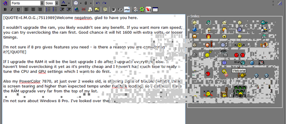

As my 7870 is now it is way too loud and hot to overclock to any useful extent. I think my only practical options are to upgrade the card, which is only a couple weeks old, or to liquid cool and over clock the card.

Your screen tearing problem is due to not having V-sync enabled. It's not a defective card. Turn V-sync on and you solve your problem. You don't need to liquid cool that card to fix that.
That's a relief! From where might V-sync be enabled?
The picture he posted has nothing to do with vsync. Vsync tearing issue look like this:
http://www.tweakguides.com/Graphics_9.html

Now that I have a better understanding of what screen tearing is, I don't think it is my problem. Now I'm a little worried that I should return my 7870 for an exchange and I only have a few more days to do so. Is there a way to really check my card for defects? Maybe I run it at full rate rate/100% load for a couple hours? I need to find out if the card is going to fail in the near future while I still have time to return it.

As far as that artifacting goes. Does that happen immediately? After a while? Have you tried the newest drivers? If you are on the newest, rolled back a version, two? Does it happen in games?
