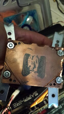

Well turns out the block wasn't sitting right. I took it off and it looks fine Arctic silver 5 is all over.. so I wiped it all off because there was too much on it and I put a super thin layer on to test if the block really was sitting right.. Its only touching on the left and right sides (or top and bottom if your case is standing up.. And the entire middle wasn't touching. Like literally only 2-3 mm on the top and bottom was touching and the whole middle and left and right wasnt.. I decided to get some flat piece of 16 gauge steel I used to fix my Jeeps floor board as its very flat and I got some 230 and 320 and 400 grit sand paper and wet sanded the block for like 40 minutes and tested it again and pressed the block on and tightened it and took it back off and now its covering the middle..
My idle temps have dropped way down.. They used to be 30-32c and now they are 25-27c, Im going to check the load now.
Whoever suggested the block might not be making contact was right.. This could explain why my water and the block weren't that warm when on load.. Im still not 100% comfortable on the contact as it wasn't 100% still.. So I decided to just sand the top and bottom parts of the block where the cpu heatspreader was touching to sand it down and tried it one more time and now its better.. , it was touching on the middle but still.. Im curious why the block wasn't flush on this cpu yet was fine with my C2D and my Athlon 64 which all had heatspreaders on the cpu's. Im wondering if the actual heatspreader on the cpu isn't flush.
The load temps as im checking now seem about the same.. Slightly lower at 4600mhz 1.22v they are at 66c using blend on prime 95, earlier it reached 90c on blend when the cpu watts went from 97w to 140w so lets see what happens as the test progresses
Yea 40 min lapping the block with a low grit sand paper and it didnt help contact much so like you said im starting to think the IHS might be the uneven part and not my block.
I never liked IHS anyway. Yea they eliminated the part of chipped corners on your cpu die but they also cause problems like this.
Id lap the cpu IHS as well but with the cpu being 340$ id rather not break warrenty lol at least not yet. So ima sand the block more on top and bottom to counter the curve.

Found this thread on google and others, seems a lot of the 4790k are concaive and they aren't level, at least I know it isn't my waterblock.
Here is a picture of how poorly the contact on the cpu is... See the big air gap lol ? And you can clearly see im using plenty of Arctic Silver 5. In fact I was using too much right there and it still wasn't touching the middle of the core. What do you think ? Should I lap the IHS ? That's a pretty big $340 gamble on losing my warrenty but that gap is kinda big
