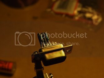

Now we need to Solder 3 x 75ohm Resistors into the Rear of the VGA Plug see pinouts diagram below

Now we should have something resembling like this
I usually put some shrink tube on so there is no fear in getting a short circuit
